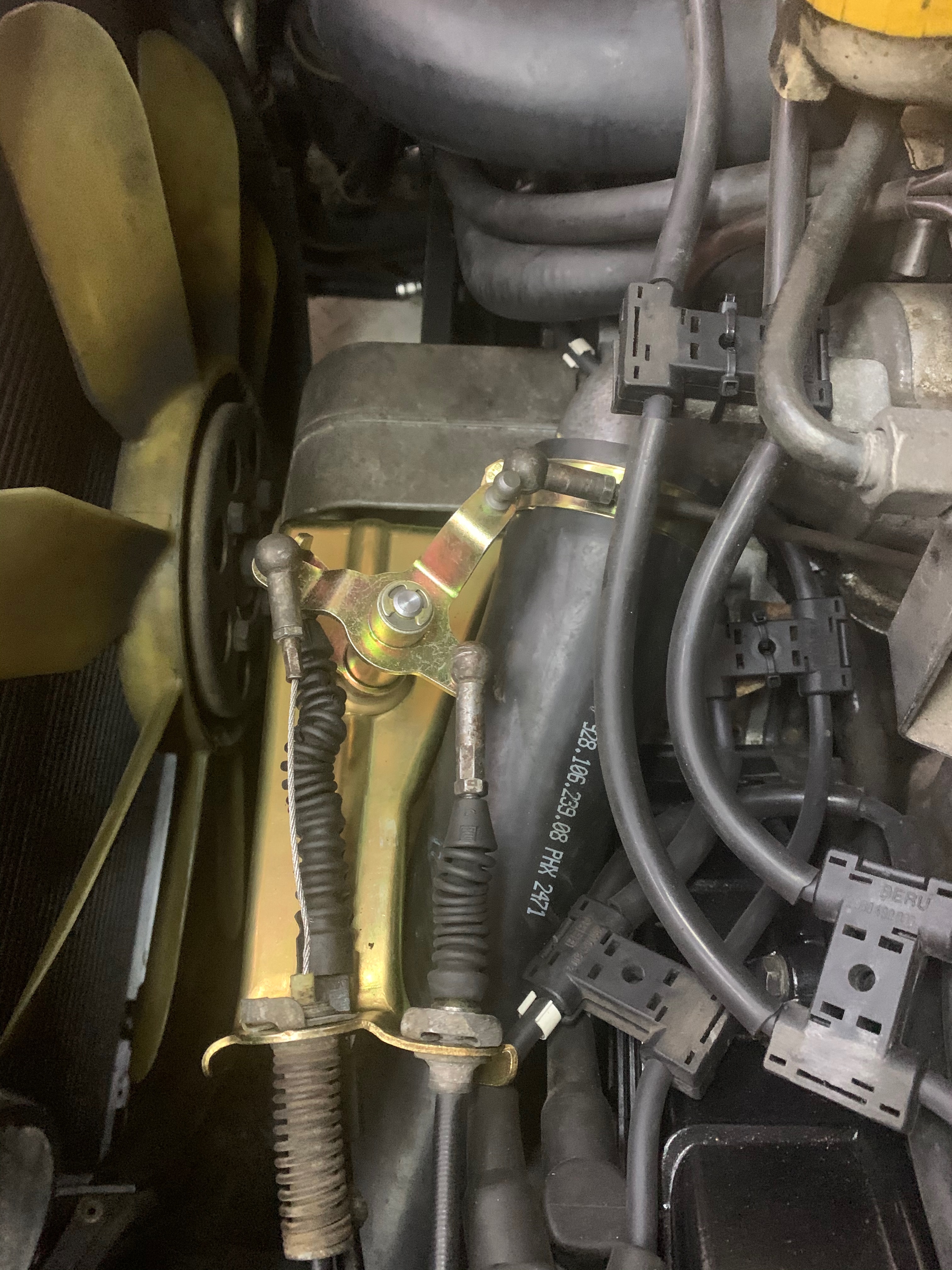

I've searched for a thread specific to the '85 32V Throttle linkage, so I apologize if there is already a thread for this that I missed. My 1985 928S 32V turns over and fires but immediately stalls.
Here are the events leading up to this:
  • The car started easily at any temperature and idled smoothly. However, the original linkage connecting the gas pedal, automatic transmission kick-down, and cruise control cables to the throttle body control rod was binding, causing a sticky throttle while driving.
    I sourced a N.O.S. assembly and installed it (see picture below). I adjusted the throttle body rod clockwise so that the socket would fit over the ball of the new linkage. The car started and idled without issue, and I could drive it.
    Not realizing the throttle body end of the rod uses reverse threads, adjusting it clockwise to make it fit on the new cable connectors unknowingly back it out of the ball socket connected to the throttle body. Luckily it came undone in my driveway.
    I removed the center manifold tube to access the throttle body plate and reconnect the ball socket to the rod and throttle body.
    With everything back together, the car turns over, fires, and immediately dies. Adjusting the rod only forces the engine to start at high revs, and even then, the car will not idle on its own without throttle input.

Welcome to Carpokes! While waiting for 928 experts to offer better-informed help (paging @dr bob et al), I have a question. If you moderate the throttle carefully, will the engine run at idle speeds, or does it simply die no matter what you do with the throttle below a certain rpm? If it simply will not run at lower rpms, I'd wonder about the mixture and vacuum leaks -- is there any chance that coupler tube isn't seated and sealing? If you can control the throttle to have it run at idle speeds, I wonder if the idle stop screw is out of adjustment? (Seems unlikely since it was ok before, but perhaps the linkage was keeping it open rather than the stop screw?)
