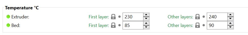

3D Print Settings
Printer: PRUSA i3 MK3 with Satin Powder-Coated Plate Sheet
Filament: MH Build PETG 1.75mm Black
Time: 33 minutes
Print Settings: No Raft, No Supports, 100% in-fill, .10mm UltraDetail
PETG Print Specs.JPG (24.12 KiB) Viewed 321 times
