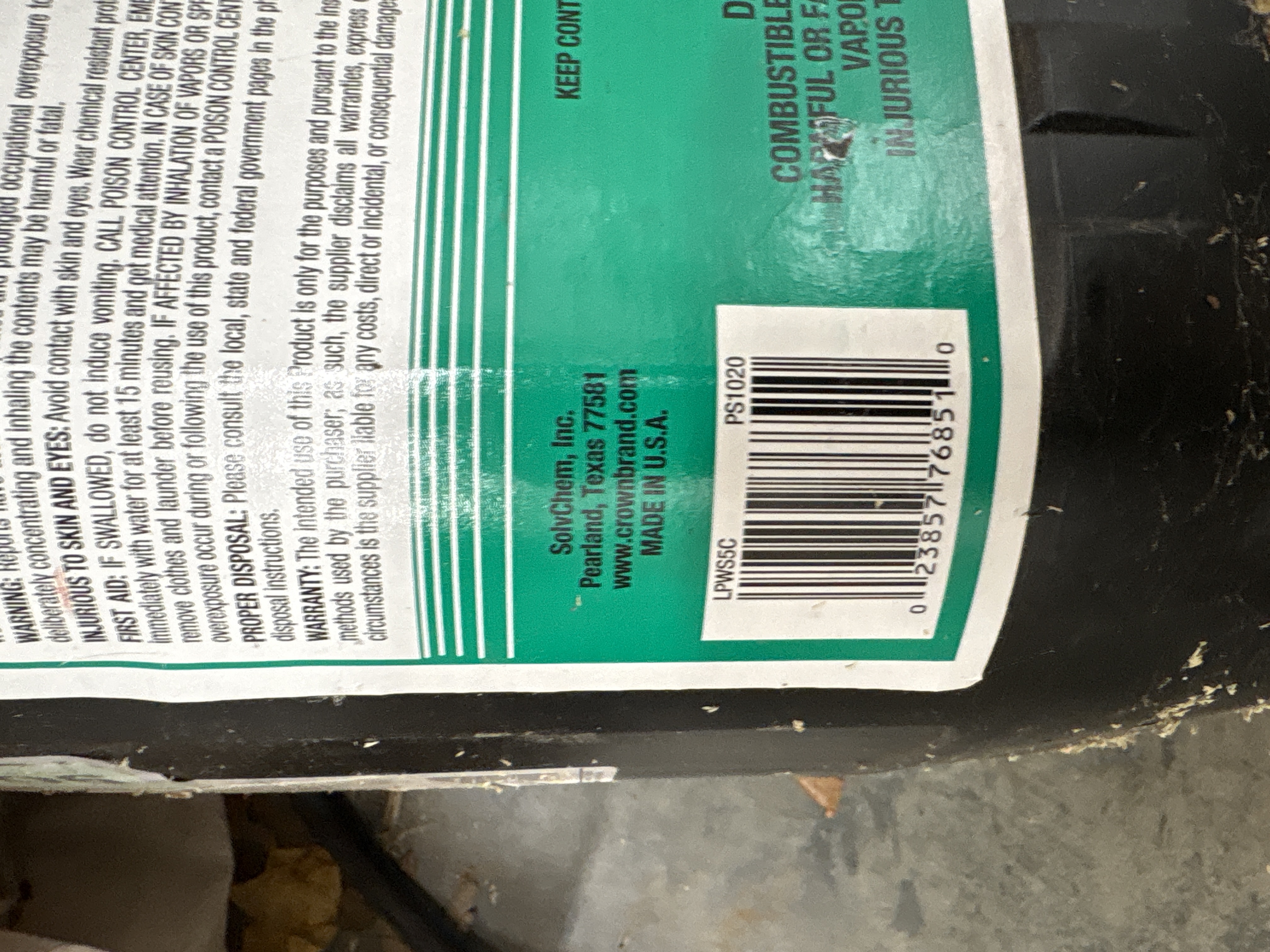

I have a parts washer and have generally had good results with a product called PSC1000. I can find it at my local Tractor Supply. I would avoid most big box store alkaline cleaners because they don’t have stabilizers that would help to reduce corroding the aluminum. You might check with local metal refinishing/plating companies or machine shops to see what they have for industrial cleaning/degreasing.
Good luck.
