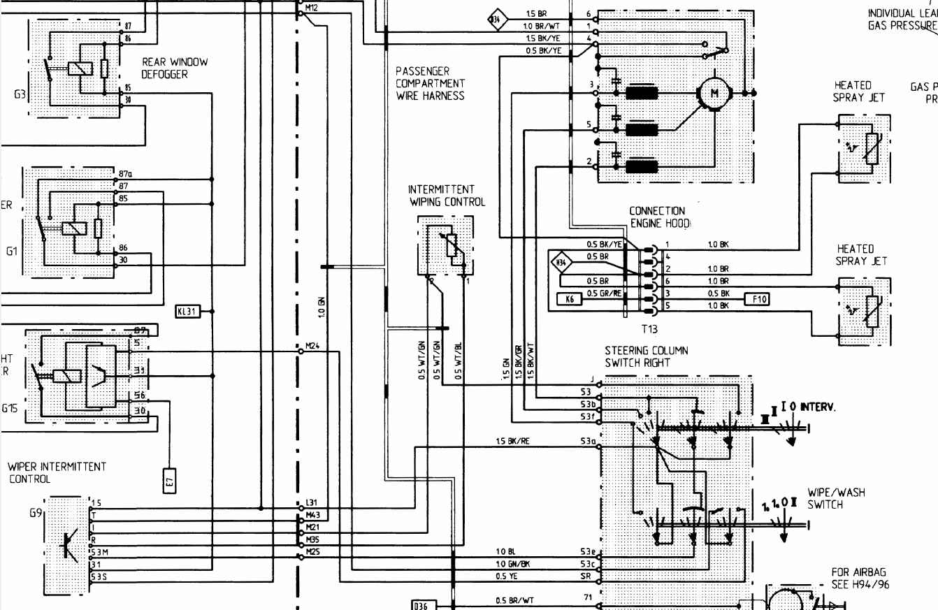

I thought I had some info on this type of failure, it really rings a bell. Although I can't find anything written, I remember seeing someone say somewhere that these issues are often traced to a problem with the intermittent wiper relay. Looking at the relevant part of the wiring diagram though, it seems to me that both the speed 1 and 2 issue and the parking problem will either be a wiring fault on the way to the motor or a fault within the motor, like a corroded connection (seeing as you just replaced the control switch).
When the wipers are parking themselves, they get their power from the blk/yel on pin 4 of the wiper motor; it ultimately comes off fuse 24 and is also used for the heated wiper jets. Checking these points for +12 with the key in run would be a good test.
Removing, taking apart and cleaning the wiper motor is certainly within your skill set. I'm planning to do a blog episode about what I did to overhaul my wiper system, but I'm not sure when that's going to happen. Happy hunting!

Thanks Ian! I’ll check for 12v. I’ll price out a relay to see what those go for as well. I know this car sat outside for quite awhile at some point in its life so my hunch is I’m going to need to pull the wiper motor. At the very least I’m sure it needs a good cleaning. I’m most worried about cracking the blower cover. It was replaced with the 968 piece at some point and those things are over $200.icb wrote: Sat Mar 02, 2024 6:23 pm I thought I had some info on this type of failure, it really rings a bell. Although I can't find anything written, I remember seeing someone say somewhere that these issues are often traced to a problem with the intermittent wiper relay. Looking at the relevant part of the wiring diagram though, it seems to me that both the speed 2 and 3 issue and the parking problem will either be a wiring fault on the way to the motor or a fault within the motor, like a corroded connection (seeing as you just replaced the control switch).

+1 on trying the relay first, and then opening up the motor and cleaning it up (or getting a new one). It has wiper contacts kind of like the horn behind the steering wheel, which can get gummed up and/or just wear out over time....
