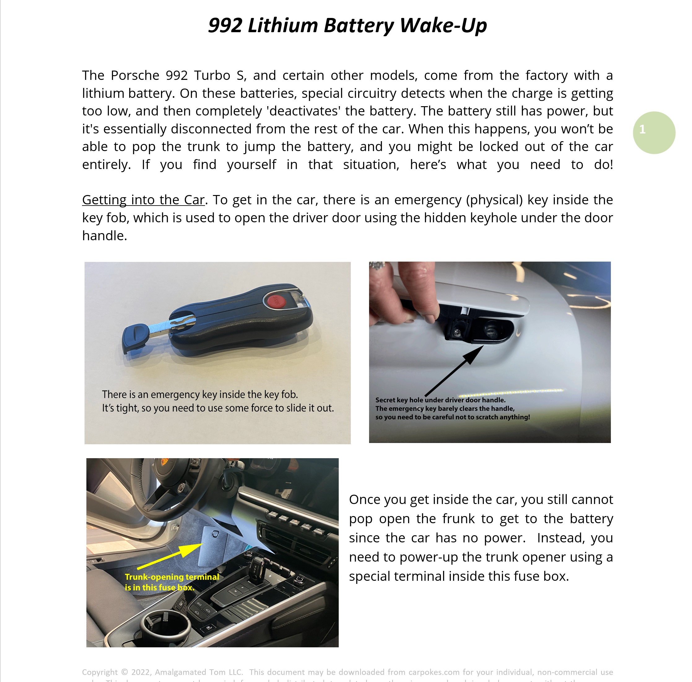

This downloadable PDF explains how to 'wake-up' the lithium battery in a 992, in the event it gets too low and shuts itself off. Might be useful to carry in the glove box just in case. Finding this info in the owner's manual, on the side of the road, is not fun....
992 Dead Battery PDF.pdf
